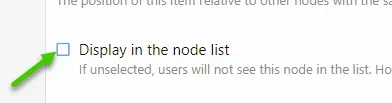

I have three forums that are not included in the regular node list - in the settings I unchecked the 'Display in the node list'
I have used the node urls to create access in a drop menu and there is no requirement or need to duplicate the entry access points.
My issue is that because these forums are not included in the node list, they cannot be searched and that is causing a problem that I would like some kind of resolution to. So, to that end, is there a means to get these included in the search parameters without showing them in the node list because, as I have pointed out, this would be a redundant course of action in duplication.

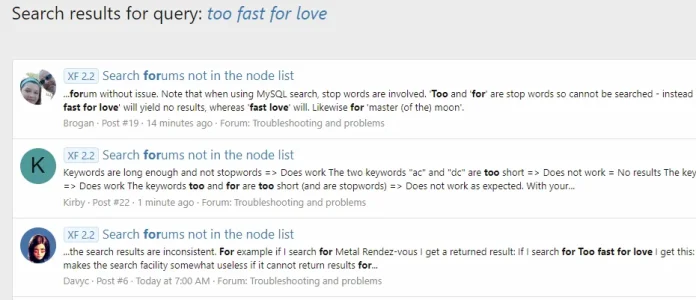

If I search for Too fast for love I get this
1634727402752-png.258885
The keywords too and for are too short (and are stopwords) => Does not work as expected.

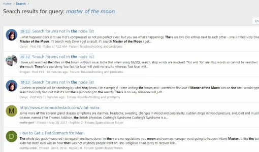

Which is completely useless as people will be searching by what they know. For example if I were visiting the forum and I wanted to find out if Master of the Moon was on the site I would type that into the search box only find out that it's not there (according to the search). There is no way someone will just type Master, or Master Moon.

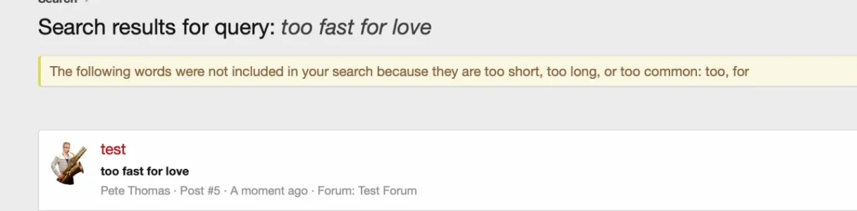

I tested this on one of my forums and no problem. I mentions the short words, but still finds the post.:
I'm presuming that the search ignores the / as a character as the name AC/DC with the slash is five characters long lol.
No, I think it sees two x two-letter words.
I tested this on one of my forums and no problem:

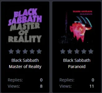

Here's another example - take these two titles side-by-side in the forum:

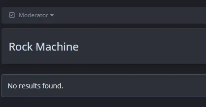

I search for 'Master of Reality' and I get this:
Not even a statement about the following words being omitted because they were too short - the operative word in this search being 'of'

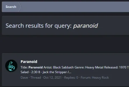

I search for 'Paranoid' and I get this:
One word titles are not an issues unless they are less than 4 characters long, but why is the word 'of' in 'Master of Reality' saying no result when it should show the result but state the word 'of' was omitted from the search because it's too short? Something isn't right somewhere if it works on one forum but not another. I even thought some of my modifications may be getting in the way, so I reverted to the default theme and the issue was the same. Strange!
