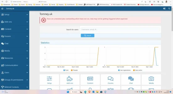

Hi,
I'm getting this error in the index page of admin any idea why? I turned on Enable board URL canonicalization but it does nothing... Also added a image.
There are scheduled jobs outstanding which have not run. Jobs may not be getting triggered when expected.

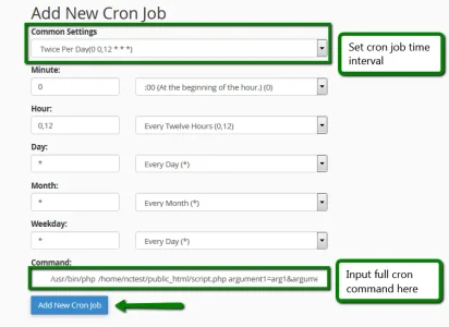

Any idea what common settings I should add (see picture) as well as minutes, hour, day, month and weekday?
You have to set it to run every minute.
How your panel controls that, I don't know since I create mine from the CLI using crontab -e.
