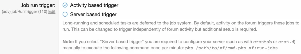

XF job trigger system will then execute the job when it is due, either through the client via XHR calls to job.php (default)
So this means it runs automatically and is not dependent of a visit to the site, right? However, how would an XHR call happen if there's no user to provide a client (browser)
As said before, it depends on how the job trigger is configured. By default clients will trigger job execution via XHR calls - if there is no traffic no jobs will run.
If jobs absolutely must runnon time you would have to either assure that there is sufficient traffic or use system cron.
But doesn't that still require traffic to execute? Sorry, trying to understand which one should I go with.
Just FYI, you can set up the cron to make an http request to job.php. However, a cleaner way to do it that doesn't rely on your web server would be to use XenForo's cmd.php system and just set up a cron to run the command php /path/to/xf/cmd.php xf:run-jobs.
You can run jobs both ways, or you can also make that the only way XenForo jobs run under System and performance options (it's an advanced option).
