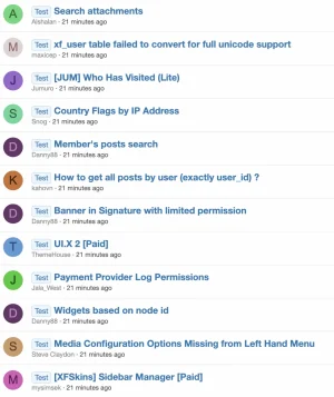

But indeed, I can't reproduce any issue with prefixes being applied to incoming feed threads:
Not currently. There have been no changes here, nor can I see any reason why it wouldn't work. If the feed has a prefix applied, that prefix will be applied, in my testing.
