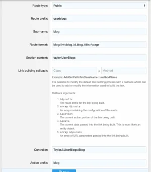

So it does turn out that the way I had my routes setup for blogPosts was a bit off and now the issue from post #4 above where the link builder wasn't adding the post id but I've since figured that out.
