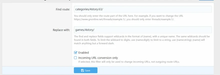

Found another bug, wasn't sure if I should make a new thread but since it's related to route filters, I will stick in here.
I am trying to rename: https://www.gnonline.net/categories/pokémon.333/
But I think because the url has the "é" it doesn't want to work.
Edit: When I posted the url in here it converted the "é" to "%C3%A9" so I figured if I replaced the "é" with that, it will work and it did.
But if I hadn't posted the URL in here and discovered that, I would not have known.
Can you explain this then? Has this been fixed too?
No, though that's expected. If you're doing matches or replacements you need to use the version that will be used in the URL, which is URL encoded. Anything outside of "basic" characters will be URL encoded automatically as they're not valid in URLs otherwise.
