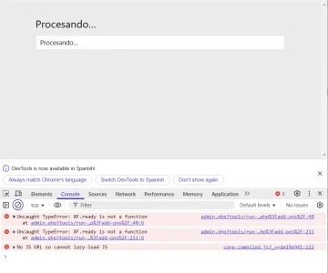

This (2.3.6) is the second time I try to upgrade from 2.3.4.
This time I followed what @Chris D suggested: disabling all add-ons, rebuild and then re-enabling them.
But the result was the same: as a minor bug I found (once more) that the timestamp on all threads changed to something like x-x-after today (I didn't take a screenshot, sorry). The major one was that I couldn't update the Enhanced Search because the system stopped responding. The screen said ‘processing’ but there was no evidence of it as the orange progress bars on the screen. Once I refreshed the page I found that the E.S. update hadn't even downloaded as the CP was asking me -again- to update the addon. Same behavior when I tried to disabl any addon manually from the ACP
Moreover this is what the console said:
So, I have decided not to update neither XF nor ES while waiting for a version that solves these problems.

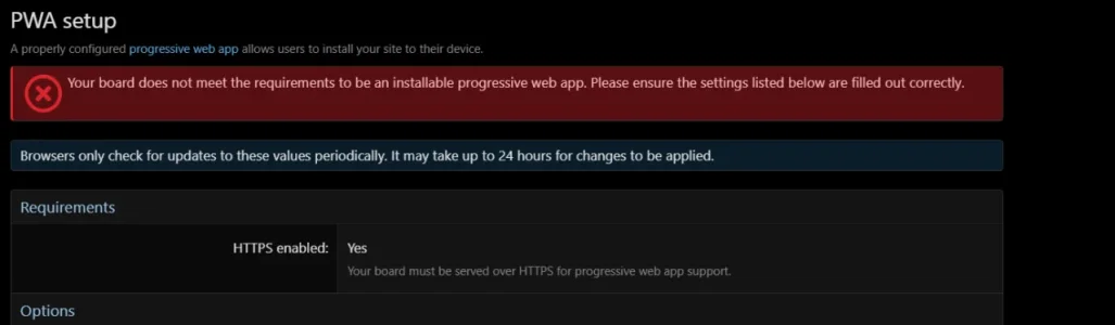

I had this issue of OP
Used /install/index.php?upgrade/
To force rebuild master data.
Board back online but
/admin.php?pwa/
Says "Your board does not meet the requirements to be an installable progressive web app. Please ensure the settings listed below are filled out correctly."
The Install the app link is still there and it does install the app, and the app works.
Idk if this option will disappear in 24hs though.
