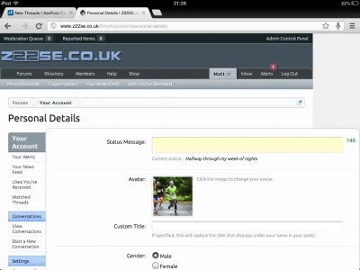

Issue with the account details page when viewing on the ipad2
You could try this in extra.css
/*Mobile CSS*/
@media only screen and (max-width: 700px), only screen and (max-device-width: 700px)
.accountContent .xenForm {
    margin-top: 0;
    width: auto !important;
/*Mobile CSS*/
.xenForm {

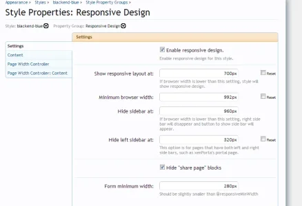

After install of Responsive Design my main style looks like this:
Might consider using a fluid style to replace my mobile design with this add-on, but was wondering if we could just tweak the addon so that I won't have to?
Sure, its possible to fix by changing some properties and/or adding extra rules to responsive_extra.css template.
For some reason I'm seeing your mobile style when visiting your forum instead of main style and no ability to switch to normal style. Please switch to normal style, so I could take a look at layout issues.
Ok, I have disabled the Auto-Style Switcher. So these are the settings I have now:
That will require a lot of tweaking. Add this to responsive_extra.css
.fblbCenterOuter, div.xenCODE_ForceRegister, #wibiyaToolbar, #ticker-wrapper { display: none !important; }
.backDay { background-image: none !important; }
Change back minimum width to a reasonable number instead of 992px
It might require more tweaks after that

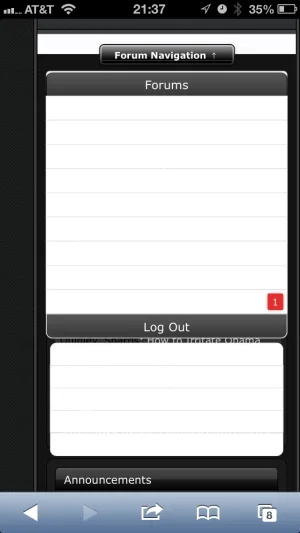

Where would I change text color for Forum Navigation box? It's displaying white on white on one of my dark styles.
Also, forum is centered on iPad but shifted to the left on iPhone (5% space on left) No ads in the way on this style either.
