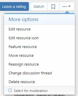

It's an individual process, but you can point a resource to individual discussion threads, so you can resolve the issue:
