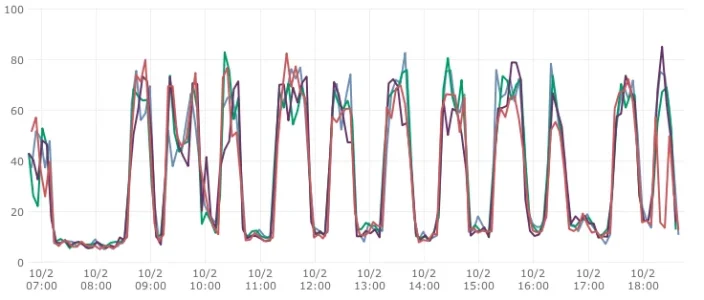

I could really use any help / advice or just a point in a good direction. Our Xenforo Install is having these massive processor spikes and I can figure out what is causing them. Here is what it looks like:

By the looks of the timing of the spikes, it looks like some sort of cron job -- most likely not a default one. Do you have any that start around the 30 minute mark of each hour?

They are Apache + PHP systems that connect to an AWS RDS MySQL server. Both MySQL AND the Servers Spike together. I have the long_query_time set to 300ms but nothing is coming up. i have since lowered it to 200ms and I am awaiting to see if anything is captured. As far as anything changing, unless it was automated (Which I don't have much of) Everyone here hasn't touched the system in a month whether it be server or the Admin back end.

Since it seems to be happening quite frequently, you should be able to get away with disabling all/almost all cron entries for an hour or so to see if it stops. Conversely, it could simply seem to be one of those "cascading failures" things: one slow page causes a backlog that just gets worse for a while.
