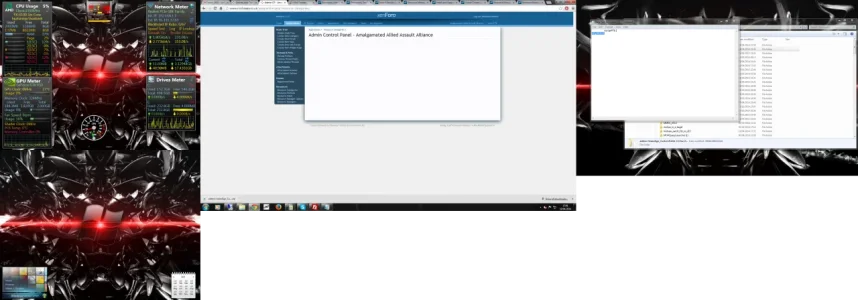

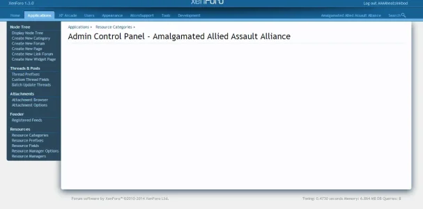

Hi having this issue where the Resource admin menu has the following problems -:
Resource categories -: after clicking loads page but just the title is displayed
Also get the same for Resource Prefixs and Resource Fields
Not sure when it stopped working but have many fields added :(
To note Resource Manager Optins and Resource Managers do work
Have Restarted the Server - rebuilt cache and permissions and have also run file health check
also seeing the same on Custom Threads Fields...........
The site is working www.mohaaaa.co.uk/aaaa
And existing Resources such as downloads are all working and forum custom thread fields also working.......

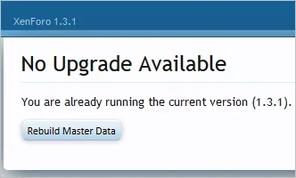

Just waiting to try the update - 1.3.1 (not got access to the updated download from xenforor custom area waiting on my other admin for that)
Attempted as you said Mike all finished ok but still same issue, Its strange as I said as the existing custom fields and resource downloads are working ok on the site also able to create new posts with the fields.............
