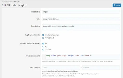

Alright, I've copied the settings in the screenshot at that link and enabled the code but my board won't display the test image I'm linking to. A broken image icon appears in place of it. This is how the config looks on my panel:

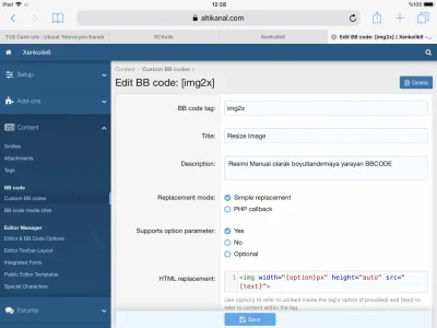

Strange ?? It should work. This is how I configure and use without any problem.
