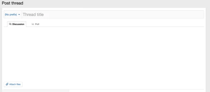

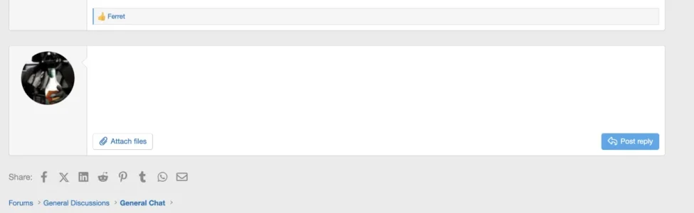

got the same issue, updated to 2.3.3 from 2.2
and the editor is missing, added a new style. i cant find where the option in the CP is to turn off rich text editor or wyswig mode change?
EDIT, should of mentioned i turned off all adons, checked the config.php file, and then turned off cloudfare and cleared all cache, but still the same.
