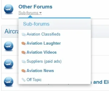

ibaker
Something like this should work (added to the extra.less template):
Less:
.node-icon i { display: none; }
.node-icon { background-image: url('styles/default/xenforo/xenforo-favicon.png'); background-repeat: no-repeat; background-position: center; }
.node--read .node-icon { opacity: 0.5; }
It hides the icon (the i element) and adds a background image to the icon container. The above example just reduces the opacity of the image if the node is read (though you could also display a different image entirely).
Thanks @Chris D but what about the icons in the sub forum drop down list:

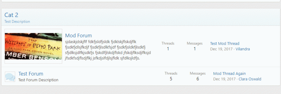

Vilandra
Can anyone help with putting a border around the custom image? Adding border: 1px solid #00000; to the
.node--idx .node-icon {} didn't work - it puts a border around the whole block like:
Anyone have any idea? Thanks :)
