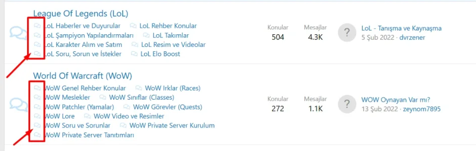

How to change sub-node icon in forum homepage with png images as read and unread?

Any way to change the sub-node icon in a dropdown menu on the default style?

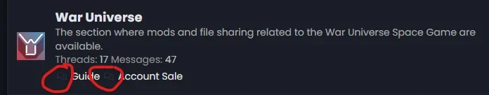

However, it doesn’t work in XenForo 2.3.
it's there any new css for fix this?
Thanks.

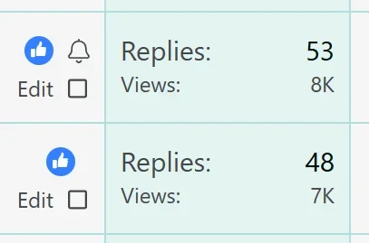

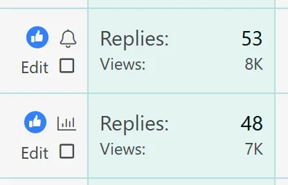

It works, but the poll icon and other icons in the thread list view have disappeared :(
Just tested and it all works fine.
You are showing me the forum_view, but this code changes the icon for forum node on the forum_list template. And if I add that code, I can still see the poll icon in the forum_view. So there must be someting else.
