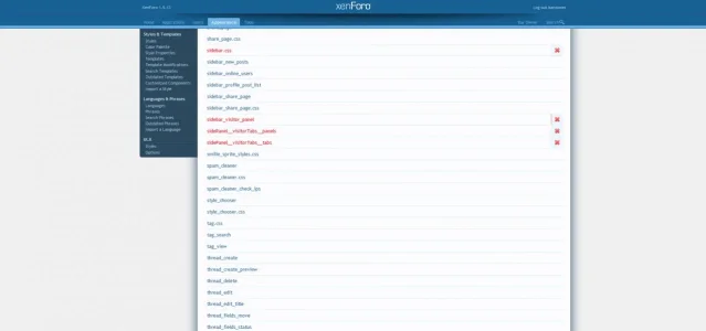

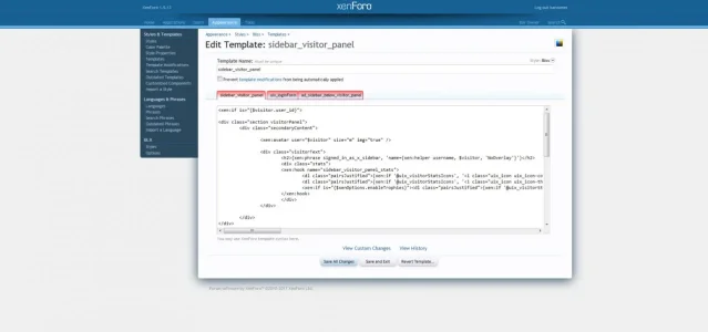

Thanks for the quick response Brogan, I tried that and it had no effect.
My confusion here is two-fold:
1) I'm not sure I can edit "sidebar_visitor_panel"? The reason I ask is the template is red in color with an "X" as depicted in attachment "Admin Template 1." I went through the steps to test for use of variables in the template and did not receive a "null." To further illustrate, the tabs in the template are red in color as well in the attached screen shot named "Admin Template 2."
2) The "if" statement is already being used in the template (see first line of code in attachment titled: "Admin Template 2. I seem to be caught in a vicious cycle of methods that do not accomplish the task.
I am new to XF so I apologize for the trouble if this is something very obvious...

Maybe I should ask a specific question. If I use the "if statement" method as you propose; where do I actually put the additional conditional statements in the code below? The below code is the "sidebar_visitor_panel" template. I would like to know what the red color represents as well...
<xen:if is="{$visitor.user_id}">
<div class="section visitorPanel">
    <div class="secondaryContent">
        <xen:avatar user="$visitor" size="m" img="true" />
        <div class="visitorText">
            <h2>{xen:phrase signed_in_as_x_sidebar, 'name={xen:helper username, $visitor, 'NoOverlay'}'}</h2>
            <div class="stats">
            <xen:hook name="sidebar_visitor_panel_stats">
                <dl class="pairsJustified">{xen:if '@uix_visitorStatsIcons', '<i class="uix_icon uix_icon-comment Tooltip" title="{xen:number $visitor.message_count} {xen:phrase messages}"></i>'}<dt>{xen:phrase messages}:</dt><dd>{xen:number $visitor.message_count}</dd></dl>
                <dl class="pairsJustified">{xen:if '@uix_visitorStatsIcons', '<i class="uix_icon uix_icon-thumbsUp Tooltip" title="{xen:number $visitor.like_count} {xen:phrase likes}"></i>'}<dt>{xen:phrase likes}:</dt><dd>{xen:number $visitor.like_count}</dd></dl>
                <xen:if is="{$xenOptions.enableTrophies}"><dl class="pairsJustified">{xen:if '@uix_visitorStatsIcons', '<i class="uix_icon uix_icon-trophy Tooltip" title="{xen:number $visitor.trophy_points} {xen:phrase points}"></i>'}<dt>{xen:phrase points}:</dt><dd>{xen:number $visitor.trophy_points}</dd></dl></xen:if>
            </xen:hook>
            </div>
        </div>
    </div>
</div>
<xen:else />
<xen:comment>
<div class="section loginButton">
        <label<xen:if is="@uix_loginTriggerStyle == 0 && @uix_loginTriggerStyle != 3"> for="LoginControl"</xen:if> id="SignupButton"><a href="<xen:if is='{$xenOptions.registrationSetup.enabled} && (@uix_loginTriggerStyle == 2 || @uix_loginTriggerStyle == 0)'>{xen:link register}<xen:else />{xen:link login}</xen:if>" class="inner{xen:if '@uix_loginTriggerStyle == 3', ' OverlayTrigger'}"{xen:if '@uix_loginTriggerStyle == 3', ' data-cacheOverlay="false"'}>{xen:if $xenOptions.registrationSetup.enabled, {xen:phrase sign_up_now}, {xen:phrase log_in}}</a></label>
    </div>
</div>
</xen:comment>
<xen:if is="@uix_loginFormSidebar">
<div class="section loginForm">
        <h3>{xen:phrase log_in}</h3>
        <xen:include template="uix_loginForm">
            <xen:set var="$sidebarLogin">1</xen:set>
        </xen:include>
    </div>
</div>
</xen:if>
</xen:if>
<xen:include template="ad_sidebar_below_visitor_panel" />
Around the template code you want to be affected by the conditional statement.
<xen:if is="{$statement}">
Content
</xen:if>
I put the statements directly before and after the "div" that contains the stats code; however, the stats box remains - I tried multiple "cleared" browsers to ensure it wasn't a cache problem. Please advise...
            <div class="stats">
            </xen:hook>
            </div>
            </xen:if>
        </div>
    </div>
</div>
<xen:else />
<xen:comment>
    </div>
</div>
</xen:comment>
        </xen:include>
    </div>
</div>
</xen:if>
</xen:if>

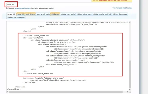

Wrong template, check forum list:
Wrap this conditional:
<xen:if is="{$visitor.user_id}">codehere</xen:if>
around that red boxed code to show that block only to logged in users.
