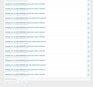

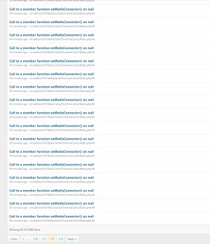

? I didn't - I upgraded as you'd expect/normal - as I have for many years with this add-on.
The last upgrade, immediately crashed the forum.
3,000+ server error logs - mainly;
After the crash, I rolled back and 2.14.0 works as it always did.
My XF is v2.2.13

Will be fixed in the next version, which will be out after some more testing. The fix till then is to remove the $config['cache']['config]['redis'] key, or stay on v2.14.x
This is unrelated to my add-on, but could be an artifact of the caching layer being broken when templating was invoked.

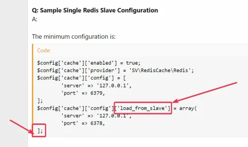

Also from your FAQ, load_from_slave is used with single replica but load_from_replica is what being discussed in this forum, should it be load_from_replica for single redis slave?
And note that in your FAQ, the single replica end with array ends with ]; I think it's wrong and it should have been );
I've updated the FAQ with the correct terminology; load_from_replica, since redis has moved away from master/slave to primary/replica terminology.
It has actually been a while since I've looked at the replica support. It looks like you can make load_from_replica and array, but it will pick a random replica and ignore the replica_select_callable option.
