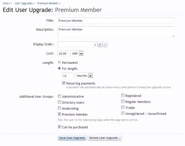

I've got a recurring subscription set up for our Premium Membership.
It's starting to roll around to 12 months, so the first one has renewed today (12:02)
The subscription has gone through fine, but it's not kept the member in the user group.
This is what I've got set:
Any thoughts?

I think I've actually figured out what has gone wrong with this. I actually changed the amount of the subscription a few months back, and when the renewal has come through today, it's come back with this error:
Invalid payment amount
I increased it from £5 to £10
All the current subscriptions are on the £5 amount, how would I go about implementing the price increase for any new people who sign up to it?
Normally, I'd say the best bet is to keep the price the same, make that upgrade unpurchasable and create a new one at the higher price. I'm not sure if we track data in the system to be able to handle this more gracefully.
