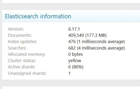

Running both Xenforo 2.3.5 and Enhanced Search 2.3.5. We got it operational but how worried do I need to be about the following information:
From what I understand yellow health should be fine for Xenforo purposes but what about the Unassigned Shard?

1) The Unassigned shard: is why the Cluster status: is yellow and can be ignored (your system is looking for a replica), but if your like me it drives me a little crazy.
Yellow status:
SSH command to change replicas to 0 (zero) (copy all and paste into SSH):

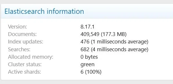

curl -XPUT 'http://localhost:9200/_settings' -H 'Content-Type: application/json' -d '
    "index" : {
        "number_of_replicas" : 0
Green status:
