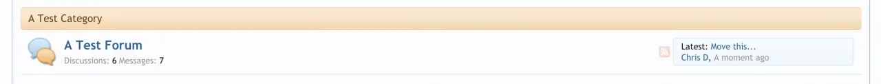

Pretty sure the second issue is the same in XF1 too.
But I need to refresh my memory on that one because I seem to recall that it happens for specific reasons which may not actually be resolvable.
I just tested it, and I was right:
I'm not saying that it means we won't look into this. It may be a case that we can't fix it, though. I just need to remind myself why it has been like this all along.
