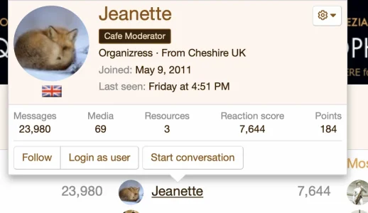

Possibly this is an issue after Content Ratings import (have already mention on Content ratings thread) but I get the feeling this may rather be a xenforo issue, as surely in both the list and in the members eaters we should see Reaction score, not just like count.
In the list of top 5 reaction score we see only the likes count instead of the total Reaction count
198300
But then when clicking through to the member details it is showing the correct Reactions score (based on the 5 types of positive reactions, not just likes)
198299
Surely both of these fields should be linking to same count?

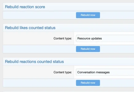

Just a quick question before I attempt this. @Jake B. had mentioned there isn't a "content reaction" rebuild tool. What does that mean? The screenshot above you showed. Are those the default reaction cache rebuilds or is one of them from andy b's addon?
@Chris D care to chime in? I want to do this right. This is due to content ratings Xon has not be upgraded yet. I know you don't recommend these types of actions but I know what I'm doing and will have backups regardless of any issue that may occur.
But I'm curious as to whether the "rebuild reaction score" option in the above screenshot is from andy b's addon or if that's actually apart of 2.1.x
That one rebuilds the reaction_score value in the user table with the value obtained from:

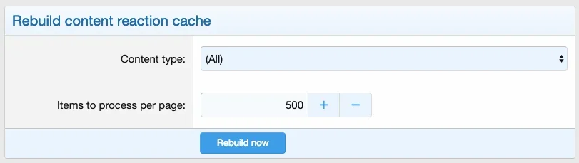

It shouldn't be able to change how the actual reactions appear in content. We had to add in a content reaction cache rebuild job (which luckily is able to run a function that XenForo defines) to fix discrepancies in the content caches:
198488
To rebuild the actual reaction content cache all that ultimately has to happen is running the following for all content:
$this->repository('XF:Reaction')->rebuildContentReactionCache($contentType, $contentId);
The way we've accomplished this is by looping through all of the content types (or only the specific content type you've selected) and getting a unique list of content IDs within that content type with the following function:
PHP:
$this->db()->fetchAllColumn('
    SELECT DISTINCT(content_id)
    FROM xf_reaction_content
    WHERE content_type=?
      AND content_id > ?
    LIMIT ?
    $this->contentType,
    $startAt,
    $limit
then triggering the above repository function with the values we've loaded here. Honestly not sure why XenForo didn't include this as it's quite helpful if you disable a reaction and want to reenable it at a later date, but I'm sure they have their reasons. We also allow this to be run via a CLI command:
php cmd.php threactplus-content-reaction-cache
