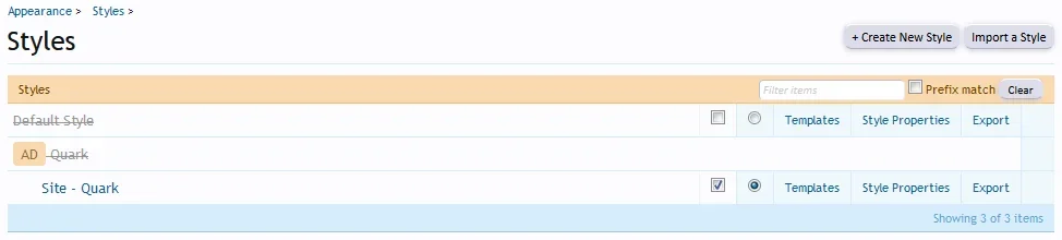

I've been reading your theme guide, and I'd just like some clarification about child styles.
Upon installing Quark via the UI.X add-on, the following structure has been setup:
I've set "Site - Quark" as the default theme.
As mentioned in the guide, I'm wondering if it's OK to create additional children, based on "Site - Quark".

Quark
-Site - Quark
--Site - Quark - Blue
---Site - Quark - Red
I assume this means any changes made to Site - Quark are "global" from that point forward, and would be copied down to other child themes? (As long as this is set as the parent).
Also, how would this work for the purpose of future updates? I understand the main Quark base theme would be updated. But does anything need configuring to ensure the UI.X add-on recognises this structure? I noticed this post you made, mentioning associating the parent.
Thanks in advance.

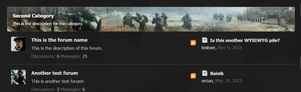

Is there any way i can get a picture for the category of the forum, perhaps its default or not? But would like to have that option. See example:
