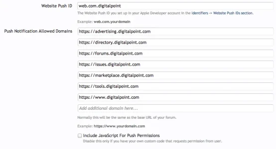

Settings
Allows you define variables rather than hacking on push package and JavaScript.

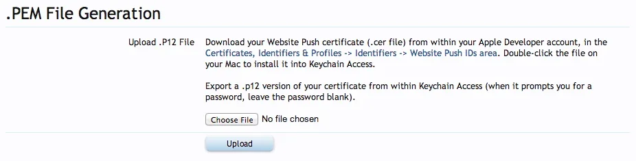

Certificate Tool
I built a tool that makes it (relatively) easy to generate the necessary public/private key .PEM file for the system.

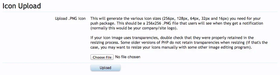

Icon Generator Tool
I even made a tool so you to upload a 256x256 icon, and then it generates the 6 various sizes/icon files for use in your push package.

You need a live Apple Developer account (or at least know someone that will generate you a Website Push certificate on theirs (no clue if this is allowed under their terms of service, but I would think it's okay). You need to regenerate your push certificate .PEM file every year since they are only valid for 12 months. This basically adds a $99/year to buy an Apple developer account (and keep it active since you have to regenerate certificate annually) if you don't already have one.
You need access to a Mac once a year when you generate your .PEM file.

Settings
Certificate Tool
Icon Generator Tool

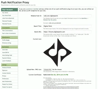

It really is annoying how many prerequisites this thing has to have... So I decided to start building a system that allows sites to utilize our servers which are already HTTPS enabled for their API endpoints.
That means that when it's done it *should* eliminate the need for a Linux/Unix type server since our servers would be generating the push package for you (which is the only reason it wouldn't work on a Windows server).
It will also mean the site will not need their own SSL certificate since they will be bouncing off ours. Since only the underlying API endpoints need to be HTTPS, not the entire site that is the destination for the user. The end user won't know the difference, and they will never be directed to digitalpoint.com in their browser or anything.
It will be a simple toggle in the addon, so those HTTPS already set up on their site with valid SSL certificates can keep everything in-house.
I still have a lot of work to do on getting it all working seamlessly, but the way it works is the site owner sets/uploads the necessary info until a new area on their Digital Point user account. Long story short is that it will be an option that will remove as much as the prerequisites/setup headache as possible.

Well, the option to utilize our servers for your push endpoints should be working now. It's just a toggle in the settings.
You then can manage it through your Digital Point account here: https://forums.digitalpoint.com/account/push-proxy

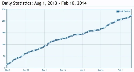

We are consistently getting a few new users using it per day. 223 users are using the OS X push notices to their desktop. If this was available on iOS already, I suspect that number would be closer to 10,000 users using it.
