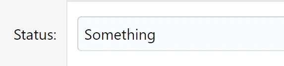

I'm wanting to do this for the AdminCP View only. If I populate the column in the DB with text, it shows up fine, I'm just unable to save the modified values via the form.

The column exists, because I'm getting data when I load the form:
