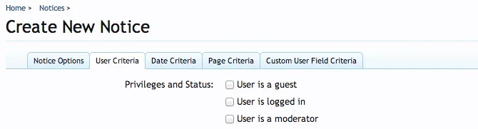

I assume you're talking about the criteria underneath the User Criteria tab?
"User is logged in"?

It's worth bearing in mind that the criteria here is used for much more than just Trophies and Promotions etc.
The main benefit of this particular criteria is for Notices. You may only want to show a Notice if a user is logged in. Notice criteria is analyzed at page load.

It's a criteria so it applies to multiple types of things. It's meaningless in the context of a promotion. It means that the user is a registered user but you can only apply a promotion to a registered user. In the case of notices (for example), this is significant though.
Similarly, the guest option doesn't make sense for promotions.
