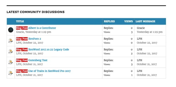

Thank you @Chris D. This is a WordPress widget with WordPress connected to XenForo 2.

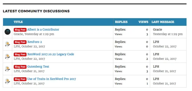

Updated the CSS label selector.
