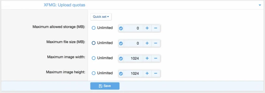

The settings for the maximum width / height of an uploaded image are actually in user group permissions. So theoretically you can have some users who can upload larger images than others. But for simplicity for now, I imagine you'd just want to apply this globally to all users.
You can do that under Admin CP > Groups & permissions > User group permissions > Registered
Find "Maximum image width" and "Maximum image height" (near the bottom of the page) and set those to a reasonable value (1024, 1280 whatever you prefer) and then click save.
This won't affect images that have already been uploaded, though we can address that at some point.

Hey Chris,
I changed the max width to 1280 on both, that was a good call.
If you look at the newest images being uploaded, they're still exceeding those dimensions so I'm not certain the change has been applied.
You might need to use Analyse permissions (and the Global permissions tab on that page) to figure out where it's being overridden.
Thanks Chris, looks like that worked finally, with your help :)
