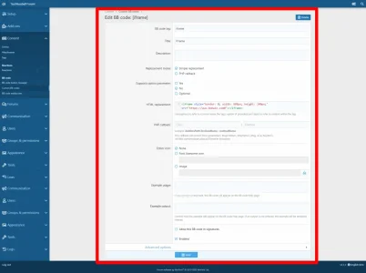

How I can make a new post in my forum with a iframe? I tried something in the cutom bb codes, see attachment:
Please help.

Since I'm creating a custom BBCode, i wish to use for multiple links, not onedomain.com - how can i replace the src with some variable link?
<iframe style="border: 0; width: 600px; height: 240px;"
src="https://www.thisvariablelink.com"></iframe>

<iframe src="{text}" style="border:2px #0000FF solid;" name="Fonte" scrolling="yes" frameborder="1" marginheight="0px" marginwidth="0px" height="400px" width="600px" allowfullscreen></iframe>
EDIT: Just to say, with some trial and error, my brand new BBCode worked perfectly, embedding the iFrame with entire webpages from any place that I want.
