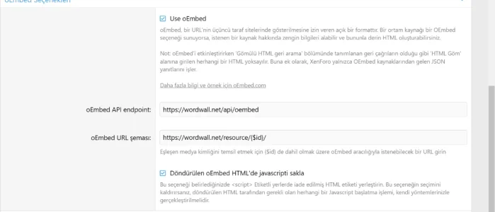

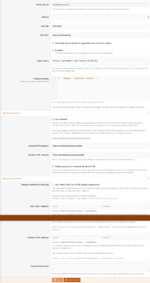

Setting up an oEmbed media site seems to work fine for me:

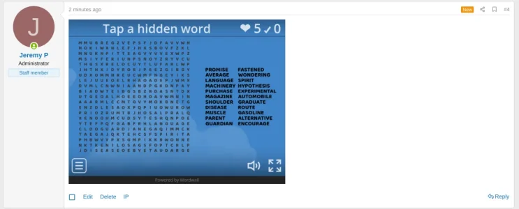

Posting, for example, https://wordwall.net/resource/52440533/wilson/step-10-wordsearch then yields the correct embed:

The only difference I note is your oEmbed URL scheme has a trailing slash and mine does not. What is the resource URL/ID you're using to test this?

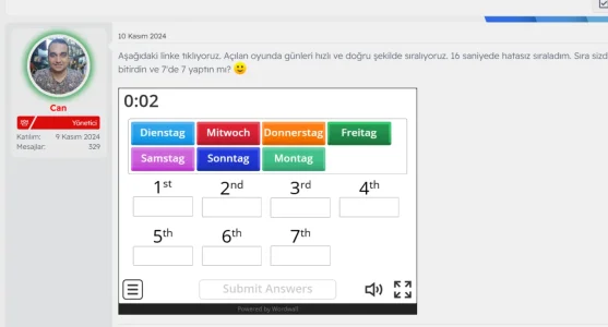

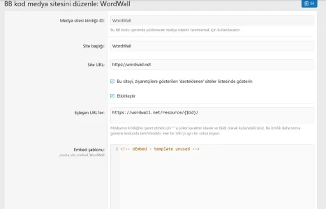

I did not write worldwallresource as the source. I added it later. I also deleted the extra slash as you said. Now it works, thanks to you. Thank you very much.
