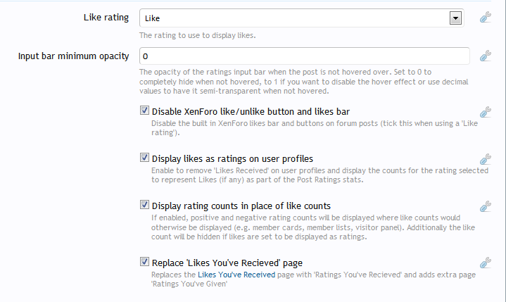

That shouldn't happen, how do your settings compare to these (disregarding opacity)?

Same as what you have. :confused:
Not quite sure why you're getting that, I'll keep looking into it
