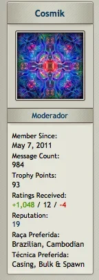

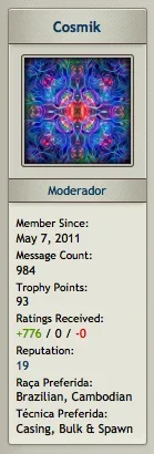

Here is a screenshot of the same user, notice the two different counts:
thread_view
conversation_view

Just dawned on me what it was doing, especially with bottiger's posts. The Count on the Staff page is just the Like count. In that screenshot I had 66 Like ratings. I guess I need to edit the XenStaff addon somehow so it can read all the rating counts...I've noticed a similar oddity but it involved a different addon, XenStaff, so I've ignored it for the time being since it could be an issue with XenStaff and not post ratings, I have no idea. The members listed on XenStaff has very low rating counts, they don't match the counts anywhere else. The post and trophy point counts in that area are accurate though.
