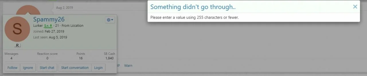

So here's how it happens: I hit the SPAM button to perform all the usual tasks to get rid of a spammer (delete messages, conversations, threads, ban the user and check the IP).
Outcome:
If I untick the options one by one, I noticed it goes through, except if I leave ticked the "Ban spammer" option which, I guess, is somehow causing this glitch.
Now, nothing gets logged in the error console in the Admin Area, while in the Inspect Element's error console I get this weird error:
  1. {status: "error", errors: {…}, errorHtml: {…}, visitor: {…}, job: {…}}
    1. status: "error"
    2. errors: {ban: "Please enter a value using 255 characters or fewer."}
    3. errorHtml: {content: "↵↵<div class="blockMessage">↵ ↵ Please enter a value using 255 characters or fewer.↵ ↵</div>", title: "Something didn't go through.."}
    4. visitor: {conversations_unread: "187", alerts_unread: "4", total_unread: "191"}
    5. job: {manual: null, autoBlocking: null, autoBlockingMessage: null, auto: true}
    6. proto: Object
which seems to be related to the hide-refresh.js file (a debug message??).
I have no clue about why this happens and since we're dealing with hundreds of spammers every day, we'd like to find a solution to this problem or a way to debug it in order to find what's causing it.
Xenforo is upgraded to latest version, and if I manually just ban the user, it works fine, but from the Spam Cleaner, the ban caused this issue.
If you need other info, I'm here, thanks in advance!
