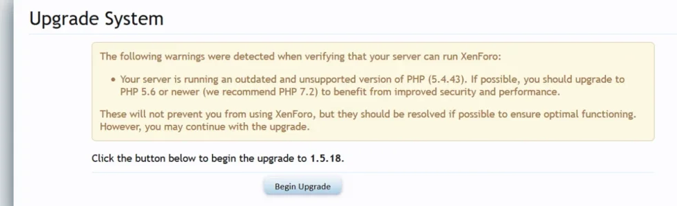

The PHP version is being reported as PHP 5.4.43 and that comes from PHP’s internal phpversion() function. It won’t be wrong :)
Checking it with PHP info as above is a good first step to confirming that. After that it would be something best reported to your host.

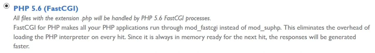

After some time with my provider and confirming that php 5.6 is indeed active, Xenforo does not appear to be reading phpversion() correctly and reports incorrect info.

Just installed xf2.03 update in its sub directory same server and admin.php?tools/phpinfo shows PHP Version 5.6.32 so xf2 IS reading and reporting phpversion() correctly where as xf 1.5.18 is NOT but reports PHP Version 5.4.43
It is a server issue, unfortunately.
We're not actively working on a fix as we cannot confirm or reproduce a bug. phpversion() returns the PHP version of the PHP binary that executed the page. It's code that we've had in use for years with many customers and we've never before had any problems reported to us - this only affects you right now as far as we're aware. The only thing we changed the other day is 5.4.0 to 5.6.0. Being as your server is reporting that you're using PHP 5.4, that's what has changed to trigger this. With all the will in the world, there's nothing we can do to change what PHP is reporting to us when running that function. It would require further investigation with your host.

Well you’ll get the same warning displaying when you upgrade to 1.5.19 too. If it’s not a server issue then it must be a bug.
