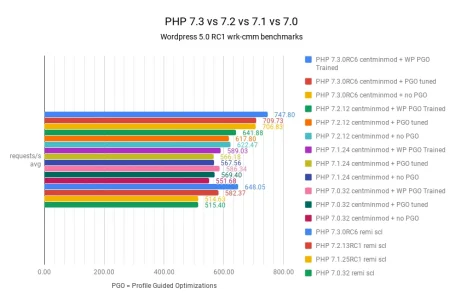

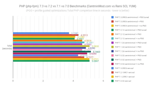

My Centmin Mod LEMP stack supports optional end user selectable building of PHP 7+ with PGO so looking to see if Xenforo PHP performance can be improved via PGO training. With PGO training PHP 7+ builds can be up to 10-25% faster from my recent PHP 7.3 vs 7.2 vs 7.1 vs 7.0 benchmarks
The PGO tuned numbers are when I specifically did PGO training for one of the benchmark scripts improving performance by up to 25% for that specific script which had regressed in performance prior.
