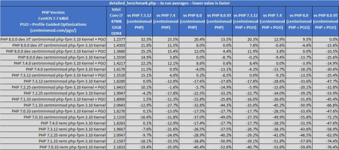

Though @Alfa1 if you're using Centmin Mod's PHP 7.3, it can potentially be as fast as other non-Centmin Mod folks regular PHP 7.4 binaries already when you enable Profile Guided Optimizations see benchmarks at PHP 7.3 + Profile Guided Optimizations can be as fast as PHP 7.4 & PHP 7.4 + PGO can be as fast as PHP 8.0 https://community.centminmod.com/posts/79730/. But really would need for specific Xenforo Profile Guided Optimization training to speed it up. Posted a thread to see if anyone can help with that to train PHP 7+ with Xenforo specific optimized code paths at https://xenforo.com/community/threads/php-coding-help-to-boost-xenforo-php-performance-via-pgo-training.156939/
Example below is Remi YUM based PHP 7.4.0 is ~28.5% slower than Centmin Mod PHP 7.4.0 + PGO enabled optimizations and ~17.7% slower than Centmin Mod 7.312 + PGO enabled optimizations and this is without Xenforo specific PGO training.

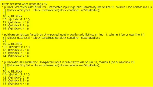

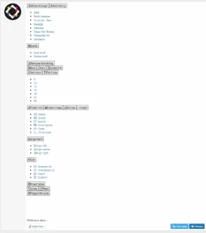

I tried PHP 7.4.0 on my test XF 2.1.5a forum which has XF full page guest caching enabled via redis caching and after a few page loads of index page, I get broken style with the following at the top in xf debug mode
quick editor seems broken too even with XF full page guest cache disabled

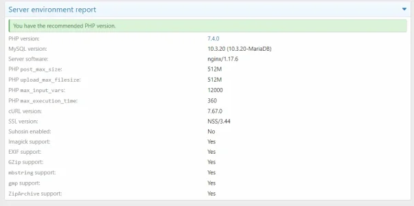

There's a good amount of changes required for XF1 to be compatible with 7.4.0, although nothing that can't be overcome. I have XF 1.4, 1.5 and 2.1 sites all running on PHP 7.4.0 now.
