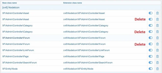

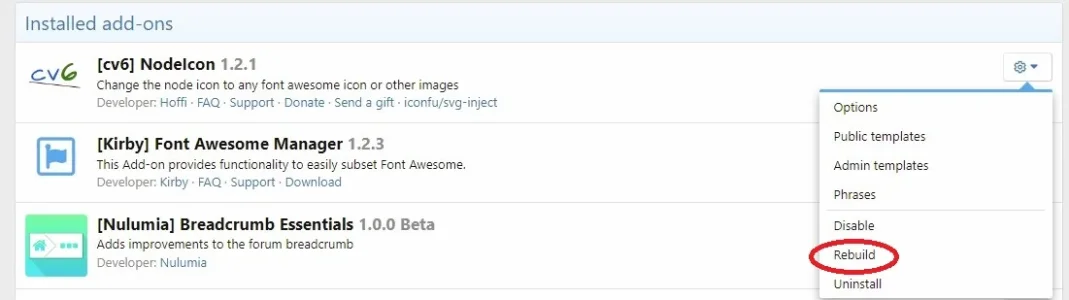

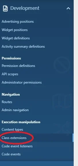

Yes. @Chris D found that when this error was showing up the add-on in question had duplicate class extensions. The duplicate extension tries to apply the same class a second time which is why you see the error.
The good thing is, it is a simple fix. You just delete the duplicate class extension(s) and rebuild the add-on. Do this by enabling "Development" mode and going to "Class Extensions" option and looking through the list. You should not see any duplicates of a class extension within the same add-on. If there is delete the duplicate(s) and then go to the add-on an select "rebuild".

The two add-ons that had duplicate extensions for me were:
Ads Manager 2
[cv6] NodeIcons
Not saying there is an issue with either add-on. It just might be a good idea for those of us that do come across this issue to keep track of the add-ons displaying this issue in case it is something that can be addressed from the add-on side itself. XenForo may also be able to implement a check for duplicate extensions if this becomes more wide spread.

You should be able to disable the add-on, and then do a rebuild which should remove the duplicate entries. No idea how they got added but I suspect something isn't 100% right with the web installer.
