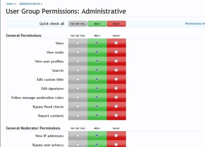

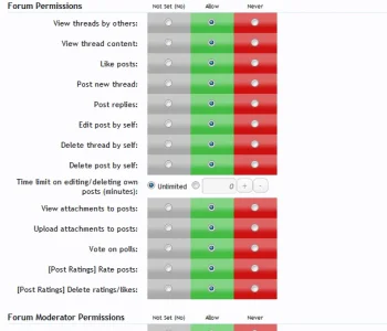

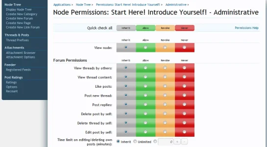

It's kind of hard to tell what is going on. If you could maybe post some screenshots of your permissions maybe someone can see what you got going on.
Thank you Will. No this isn't a free install. And I'll post some screen shots in a few.
