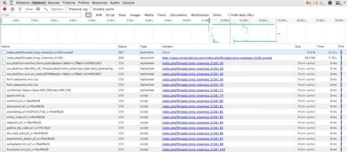

Debug started with Chrome>Developer Tools>Network trace attached. This shows that the delay is happening upon the initial click waiting for the page to be "built" by the host. See slow_response.png

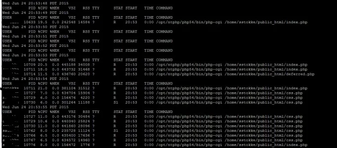

I then SSH'd into the host and ran top and kept clicking until another slow event occured. I have been able to correlate the sluggish response to a large number concurrent of "php-cgi" processes on the host. They are all tyring to run at the same time and only getting a fraction of the CPU utilization. See summary of process log trace attached process_debug.jpg It gets much worse (more php-cgi processes) but that log file is at home and I'm at work.
By monitoring the "top" output over SSH with a very fast refresh rate (0.3sec), I can see that the php-cgi processes are direct results if click events on the web site. Thus, I suspect we are just seeing a large number of users simultaneously clicking.
