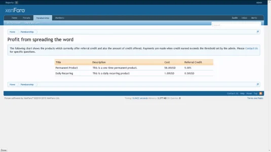

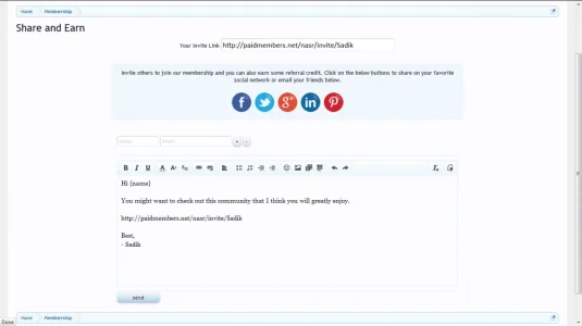

Hey Guys....
Apologies for the delay but I have good news!
Here's a couple of screenshots from the upcoming invite feature:
We are upgrading PemBer with the invite feature on our site, CrazyStrength this thursday. After it's live for a couple of days, I would release the update for customers.
