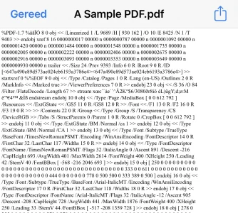

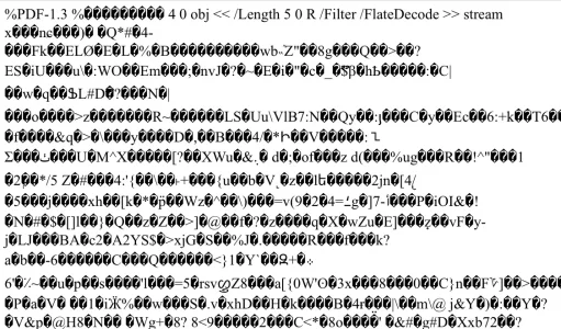

I uploaded soms pdf's to the RM. On my iMac I can see the file in Chrome and Safari.
When I try to look at the file on my iPhone in Safari and Chrome is just see some code like the attachment.
Any idea how to solve this?

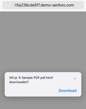

It says download file.pdf.html
Maybe the trailing .html is the problem....

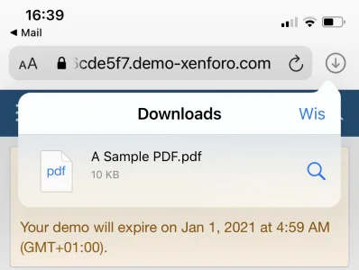

It seems like the .html being appended to the file is causing iOS devices to ignore the actual file extension.
