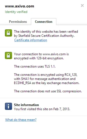

Just use Nginx and cache the SSL queries for 5min. Problem solved. :)
On top of Nginx usage, my site uses the same encryption technology Google has on their sites. Google optimized Ephemeral Elliptic Curve Diffie-Hellman key exchange over P-224 runs at twice the speed of standard OpenSSL, while atomic elliptic curve operations are up to 4 times faster. The implementation is immune to timing attacks and as far as I know, nobody else use it beside Google... not even Facebook. :giggle:
Nice, I did not know he went SSL. I told him about the Google algorithms in a Skype IM if I remember correctly...
Hmm, I see his site is open to BEAST attacks, Shawn patch this ASAP. :giggle:
Also, no session resumption... this will slow down the site.

Not really... since the SSL traffic is SPDY for the most part (connection intentionally held open for long periods by SPDY), there's not a lot of need for session resumption. Plus it gets a little tricky with how our load balancing setup across multiple web servers is (not impossible, but tricky... and really not worth it for the tiny bit of non-SPDY SSL traffic we have).
But BEAST attack, yeah... fixed.
