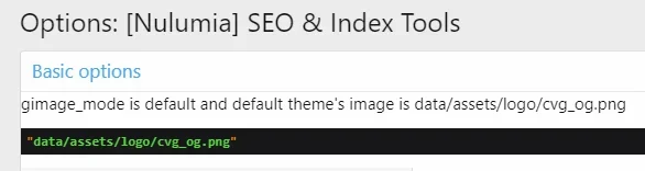

Just installed the latest alpha and get this t the top of the Options page, everything else appears to be working
Thank you for the detailed explanation. Extremely odd as there's no functionality that I'm aware of that could interrupt that area. However I'll drill down and replicate.

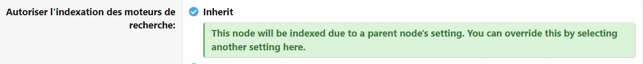

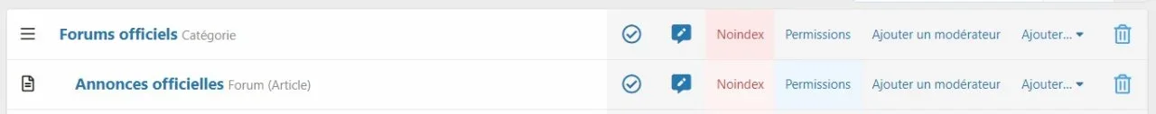

Seeing this as well on UI.X2, any node that's a page node won't be selected when viewing that page. Seems to default to the Forums node as being selected.
Now in incoming patch
The issue was patched, but seems like a rebuild for nodes should help previous issues. Next update will trigger one during upgrade process and node_id's should be resolved.

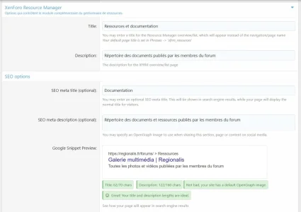

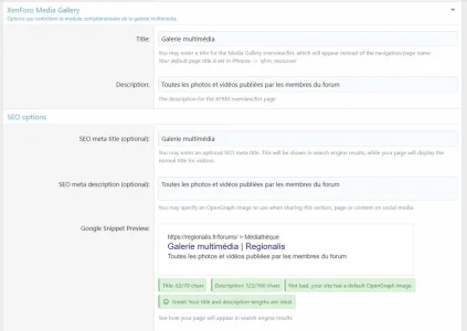

Also, there is a bug for Google snippet preview for XFMG et XFRM, same snippet for both, It's the same one that is displayed for both (that of XFMG)

There is something weird for index permissions for nodes.
if a category is set to NO INDEX and a node is set to inherit this is what it displays for the concerned node:
But this seems correct
Also which width x height do you recommend for Opengraph image for nodes and media & ressources categories.
Thanks. (y)
