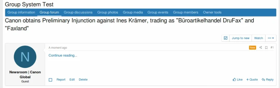

This has nothing to do with the add-on, but I do question the value of a feed with no content when it results in a post like this...
Granted you could change the RSS importer to repeat the title in the post, but that seems kind of silly. That's just my opinion, again nothing to do with the add-on. ;)
... or you can take advantage of XF 2.1.x & this add on by using filter keywords into a single thread with the title formatted & linked in the post body and then a second link that is unfurled. 😉

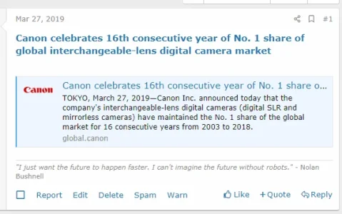

@rootsxrocks The length of the unfurl snippet is actually an XF defined length and it comes from the actual remote page content, not the RSS feed. In the scenario I described above there'd be two 'pulls', one pull of the remote RSS feed to grab the item links and titles and then if the link is on a line by itself (and you have unfurling turned on) then a second pull would be to the page in the link to grab the snippet from the page source.
The unfurl doesn't show in the RSS preview, only when the post is saved. Putting {link} on a line by itself should get unfurled when the feed is imported. Play around on a test install but to give an idea here's the RSS message template I'm using for the feed I was working with. Attached is a screenshot showing how it looks.
[b][url="{link}"]{title}[/url][/b]
{link}
... And here's the thread with Chris about the length of the unfurl snippet (Cliff Notes: The maximum length would be 300 by default).
