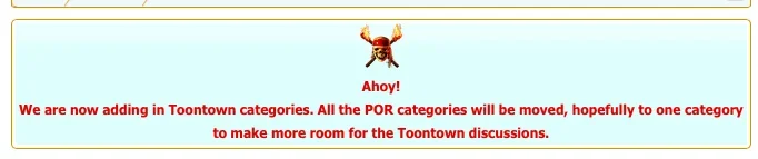

Is there a way to change the background color while unchecking the default custom styling for one notice? I just want to add in a specific background color and remove all the padding as well as have the edges of the notices sharp. Is there a way to add in the code ONLY to the notice and not to the EXTRA.CSS, if not, then what would the EXTRA.CSS be for that. It is for this notice: Screen Shot 2014-09-08 at 11.31.54 PM.webp
I just want to change the custom styling options for that notice^.
Is there a way to change the background color while unchecking the default custom styling for one notice? I just want to add in a specific background color and remove all the padding as well as have the edges of the notices sharp. Is there a way to add in the code ONLY to the notice and not to the EXTRA.CSS, if not, then what would the EXTRA.CSS be for that. It is for this notice: View attachment 83246

Oh alright. Although is there a way to completely remove the default notice styling for that specific notice? I wanted to remove the rounder edges as well. Is there a way to do this? It seems like when I added in the div tags in the HTML of the notice, I was able to change the background color of the notice, but the default round edged notice was in back of that and I wasn't able to remove that.
