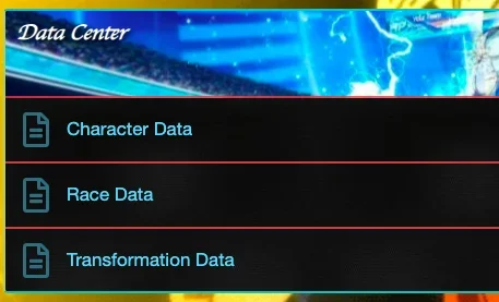

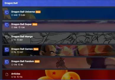

So i've been playing around with my site for a while with how but the one thing I have not figured out how to do is change the background of my node forums. Is there anyway I can get some directions on how to do it?
I would like it to be similar to this, like how it's a different background for each forum node:

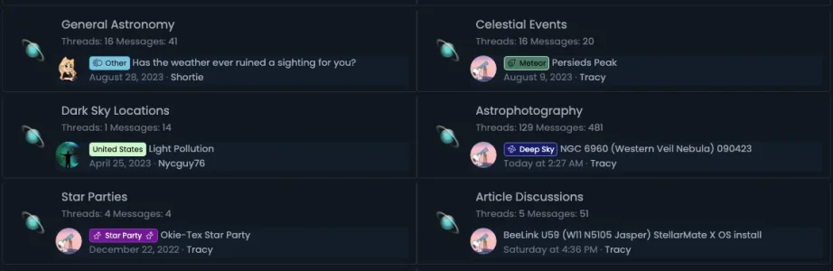

Something like this?
or maybe this?

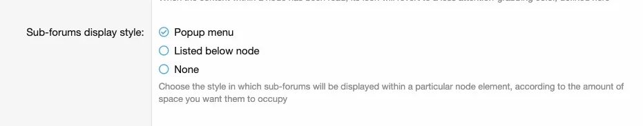

I think you are asking about something like this (where only the main nodes are listed and no sub-nodes)?
If so, that should be a style setting option.
Select None and no sub-nodes are listed.

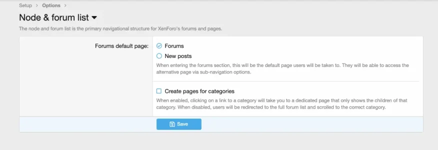

Are you only wanting the categories shown on the index page, and then you have to click into each category to see the nodes?
You may be able to use this option to create the category pages, then have a template modified to not show the nodes on the main index...
But that's getting fairly involved in template modification.
I edited my reply... but as I said, it's probably going to involve some template modifications.... and at a level that I'm not comfortable on giving guidance on.
