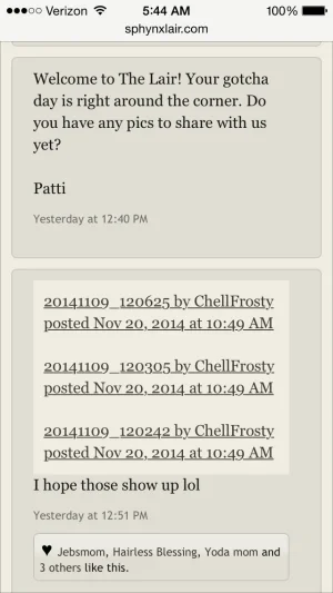

When viewing some threads, the postbit is not showing on mobile Safari iPhone ver 8.1.1 confirmed by turning Xenforo media gallery on and off.

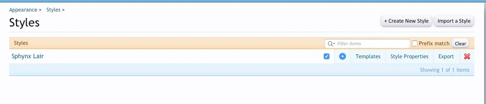

It could be your style, yes. You should try it on the default XenForo style to eliminate that possibility.
Yes, click "Create New Style"
And on the next page ensure "No Parent" is selected. That will create a new style based on the Master Style.

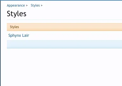

So unless I am confused, is creating a default style as you have mentioned above what you were referencing to look at to see if the issue still exists? After creating a new style I still see that the add ons exist in that style as well - etc. And the postbox is still missing on "some" threads.
