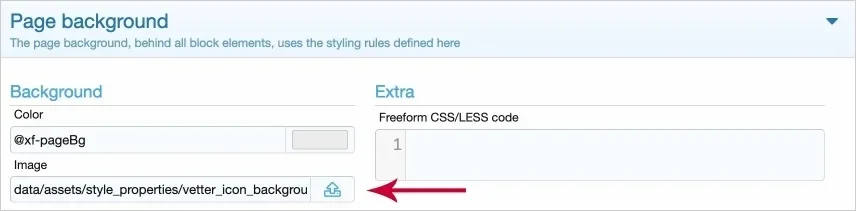

I'm able to save template changes, as well as some style properties. But I'm not able to save this one for example:
The file uploads fine, but when I go to save the page, I get the following error:

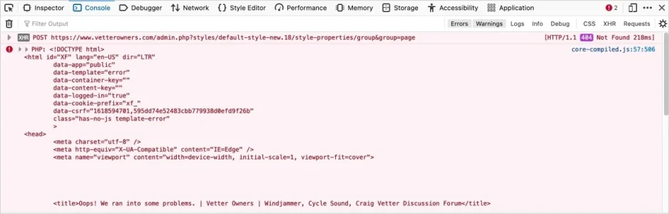

The browser console shows the following error:
What could be the issue?
Thank you.
It's returning a 404 unexpectedly. If this is not happening in all cases, then it's almost certainly some sort of security mechanism on the server that finds something about the particular request suspicious enough to block it.
It could be something like mod_security but at this point it's not an XF issue so we'd recommend contacting the host for further support.

The client is running imunify360 which is likely the culprit.

That's not the case. I've seen certain pages save fine while others do not with modsecurity. You'll need to reach out to your host.
