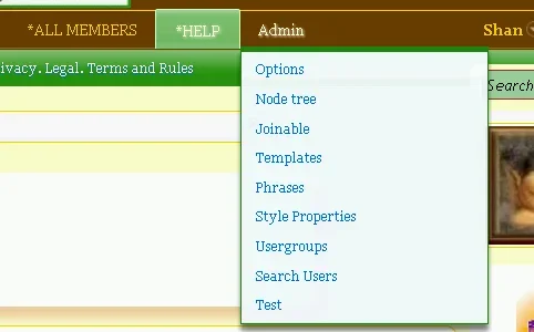

I have made myself a very useful tab with links to the admin areas I use most often.
The clever people on this thread will work it out in a flash but for others like me not so savvy here is how I did it in a step by step dummies tutorial.
http://xenforo.com/community/threads/tutorial-admin-navbar-tab-dropdown-favorites.25712/
WHAT YOU CAN DO WITH IT
Create a tab to the Admin area, with a dropdown listing your favourite admin links.
HOW TO DO IT
# Create a Link Forum linking to the admincp and make it visible only to admins. It can show on the Node list to admins as well if you like. But its main purpose is to support a navbar tab.
# Create a list of links in a template this addon provides, to go under it. You don't need to understand code to do this!
Comments should go on the tutorial thread above so as not to clutter Jake's thread here.
