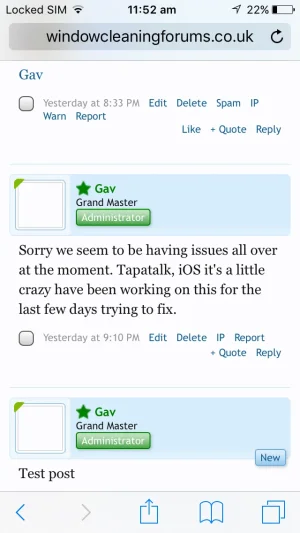

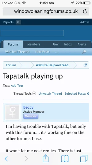

I am having several problems that only seem to be showing up on iOS mobiles.

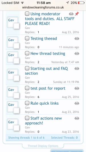

Thread reply box and post text fields don't show. Refresh the page they come back then refresh again their gone. Upload button does the same and user avatars do the same.

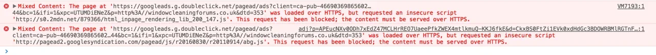

I have noticed when looking at the console on both Chrome (which you can do from PC) and Safari that you sometimes get some error messages related to adverts:
(note that I also use Google Ads and have an HTTP website but I never get these mixed content errors)

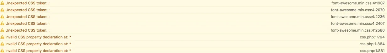

The console on Safari (which you could check out if you downloaded Safari for Windows) does show a lot of CSS errors but I don't know if this is just Safari being pernickety as I don't get them in the Chrome console.
Yeah i noticed these but from reading seems shouldnt be a problem as some ads are serving using https but our site is not https. I could be wrong however.
No i dont get these in chrome but seeing as most of the issues seem to be ios related and seem to be css/js related this could be the problem
As I said, my site is http and I serve https ads but I don't get any of these errors.

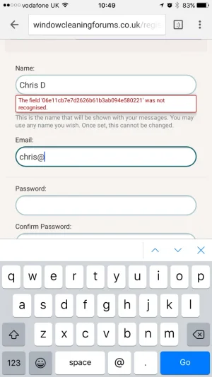

I was going to register and test but I can't:
That error usually suggests some level of caching being involved.
This could be related.
You mention specifically in your first post a "cache and data clear". I would actually look at disabling this caching completely in the first instance.
If the issues go away then it relates to the cache configuration and you should seek support from whoever provides that mechanism.

The other cause of that registration error above could be outdated templates.

There doesn't seem to be anything that triggers it. I have had about 10-15 user report so far. I was not experiencing this issue on my iphone for the first few days of users reporting it and was not able to replicate then suddenly yesterday i started to see the issues.
I've just tried again on my iPad as a guest (after cleaning browser caches) on both Chrome and Safari and I'm still seeing avatars and the XenForo logo sometimes not loading. Refreshing sometimes brings them back and also sometimes they disappear again.
Yes exactly what i am seeing and other users.

I've just tried it on the iOS Simulator (iOS 9.3) and I am experiencing some images not loading.
According to the Safari dev console the images are 404, not found. Yet if you take the URL of the image and open it in a new tab then it loads fine.
