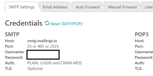

Is the SMTP port open on the server? For testing, try something like this: https://mailtrap.io/
If that works, then perhaps find a new provider? Doesn't Google have sending limits using the G-Suite I thought? I would recommend Sparkpost or Amazon SES.
You can plug this into the XF settings, with your Username/Password:
It's still likely a port issue on your server I'm guessing. I had to open a port on a Ubuntu dev box when testing SMTP awhile back ago.

Thank you, this is a great resource! When I enter my SMTP credentials from mailtrap.io everything goes through perfectly. I tried both port 25 and 465 with and without encryption.
It looks like my ports are open. I made an exception for Postfix in my UFW firewall setup in Ubuntu, and these test emails are coming through.
If mailtrap is working ok, then it's something with your GSuite configuration. I would recommend Sparkpost or Amazon SES to send emails via SMTP. I use both (for different sites), and have zero complaints.
